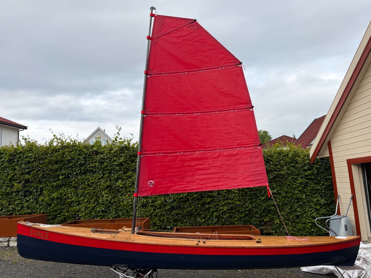

Over the winter, I have been experimenting with reefing ideas for the Waterlust, as in my sailing area, it is essential to be able to reef underway.
As owners know, there is nowhere to stow the spars and sails on deck without them sliding overboard, and because of stability issues, going forward to reef, or tie sail ties is out of the question. Everything has to be done from the cockpit.
I should add that the two reefing points on the sail, which came with the kit, are both impractical and unnecessary. Impractical as there are too many lines, and unnecessary, as with a sail this size, you can manage with no reefs or one reef. If you need two, it is time to take the sail down!
Unreefed sail:-
1.    Mast step and reefing points. I fitted a step to the mast for the boom to rest on when the sails are dropped. My first attempt (see the photo in my earlier post) didn’t work, as when the boom twisted, it twisted the supporting ‘hook’. I replace this with a flat  ‘shelf’ arrangement. A step was especially important for me as my cuddy prevents the spars from lying flat on the deck. Next, I added the fore and aft reefing arrangement described in my earlier post.
2.    The rig. When sailing close-hauled with the wind pushing the yard and boom away from the mast, it is important to restrain both spars so that they are kept reasonably close to the mast. This restraint is also important to prevent them from slipping overboard when you lower the sail.
Restraint for the yard:- You can see that the halyard is tied to the end of the yard and then passes around the mast to a block further down the yard. This means that while there is tension on the halyard, the yard is pinned close to the mast.
Yard restraint:-
Restraint for the boom:- A rope passes from the boom (aft of the mast), around the mast and through a fairlead on the boom (forward of the mast) back to a cleat on the boom within reach of the cockpit.
Boom restraint:-
3.    Reefing ties. Tying reef knots at six points along the sail whilst underway is clearly impossible in a Waterlust. I removed the ties from three of the cringles and threaded three lines tied at the boom up through the cringles and down to a fairlead on the other side of the boom. All three lines were joined (so they can be pulled as one) and brought back to a cleat on the boom within reach. These three tie lines, together with the fore and aft reefing points, are all that is required.
The reefing process.
1.    The sail is lowered so that the boom drops onto the mast step and the clew end drops on the deck, where the aft reefing cringle is attached to the hook. The sail isn’t lowered all the way down to prevent the sail and yard from getting in the way.
2.    The reefing tie lines on the boom are pulled so that the sail is gathered in as it is lowered and prevented from dropping into the water.
3.    The forward reefing line is then pulled tight.
4.    The sail is then hoisted, and any tension adjustments needed are made to the reefing lines. No need to adjust the downhaul.
Reefed sail one side:-
Reefed sail other side:-
Sail stowed. I use a bungee tied to the deck with a hook in the middle taken over the sail and spars.
Sail stowed one side:-
Sail stowed other side:-

Hi all!
It's been a while, but I see there have been some exciting developments here. I too have some stuff to share on rigs and reefing - it's obviously something that keeps canoe sailors up at night. I seem to forget about the forum here - as I never get any updates to my email inbox when someone else posts!
I have tried something completely different, and yesterday finally got out on the water with my new 'Bufflehead' style rig. I did this so that I could hopefully relax a bit without always needing to take the outriggers with me when I am snatching a quick afternoon sail between family life duties.
So - what's new?
I have a new mast - it's a re-purposed windsurfer mast, cut down somewhat and with some shims so it fits snugly in the square mast step, and a halyard sheave at the head.
I have a new sail - it's 56 square feet - fully battened fat head sail, with three reefs in it. The reefing system is interesting, in that it has a bungee on one side of the sail and plastic hooks sewn into the sail on the other side. This system was developed by Hugh Horton and others in the states after many experiements with the Bufflehead canoe and sisterships. This sail has been a looong story, it must be at least two years ago I first tried to find a maker prepared to make this for me. In the end R&J sails came up trumps and did a great job.
I have not yet made a boom (waiting for a long carbon tube), and the running rigging is all somewhat makeshift,  but I decided to take the sail out for a quick sail yesterday anyway. I notice that some recent boats with similar looking rigs are not using booms at all - see the recent 'Old Salt'.
Well, the first obvious advantage is that the carbon mast is super light, and the sail also is much lighter than the lug sail and spars. Everything is very light.
I set up with water ballast in my side tanks and set off with one reef, as I was launching from a weather shore. Initial impressions were very positive, with the boat giving an impression of 'wanting to stay upright' - which makes a change! Off the wind all was very easy. Further from the shore I decided to try reaching and beating, and out of the shelter I quickly decided to put another reef in. That worked well also, but I am using carabiners and need to change these to hooks or toggles that are quicker to swap from one reef to another. Obviously without a boom there is a lot about the sail shape I can't control, and I think that didn't help. It was also very gusty so I ended up with two reefs in (25 square feet of sail out) beating slowly home. I was quick to react to the stronger gusts and once or twice felt I had to luff to avoid a swim. When I got closer to home I tried a few times to just sit tight and see if the boat would stabilize - obviously once I decided to try this the wind never really got so strong again, but in the gusts that did come, I did try this, and was positively surprised that we managed to 'crack on' with a good angle of heel, even if it's a bit uncomfortable to sit like this! I will go out again soon with an empty boat with the express intention of turning her over just to see how everything behaves with this rig, and whether she will still 'go over' quite so quickly. I will keep you posted!
https://youtube.com/shorts/gablZkNU0qA? … FHBVzzozGQ  - to a very short video.
Here is rig 'almost ready to go' on the drive.
