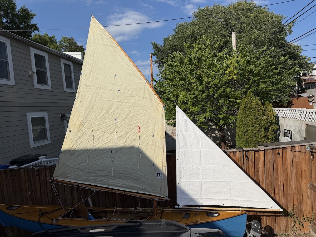

Over the winter, I have been experimenting with reefing ideas for the Waterlust, as in my sailing area, it is essential to be able to reef underway.
As owners know, there is nowhere to stow the spars and sails on deck without them sliding overboard, and because of stability issues, going forward to reef, or tie sail ties is out of the question. Everything has to be done from the cockpit.
I should add that the two reefing points on the sail, which came with the kit, are both impractical and unnecessary. Impractical as there are too many lines, and unnecessary, as with a sail this size, you can manage with no reefs or one reef. If you need two, it is time to take the sail down!
Unreefed sail:-
1.    Mast step and reefing points. I fitted a step to the mast for the boom to rest on when the sails are dropped. My first attempt (see the photo in my earlier post) didn’t work, as when the boom twisted, it twisted the supporting ‘hook’. I replace this with a flat  ‘shelf’ arrangement. A step was especially important for me as my cuddy prevents the spars from lying flat on the deck. Next, I added the fore and aft reefing arrangement described in my earlier post.
2.    The rig. When sailing close-hauled with the wind pushing the yard and boom away from the mast, it is important to restrain both spars so that they are kept reasonably close to the mast. This restraint is also important to prevent them from slipping overboard when you lower the sail.
Restraint for the yard:- You can see that the halyard is tied to the end of the yard and then passes around the mast to a block further down the yard. This means that while there is tension on the halyard, the yard is pinned close to the mast.
Yard restraint:-
Restraint for the boom:- A rope passes from the boom (aft of the mast), around the mast and through a fairlead on the boom (forward of the mast) back to a cleat on the boom within reach of the cockpit.
Boom restraint:-
3.    Reefing ties. Tying reef knots at six points along the sail whilst underway is clearly impossible in a Waterlust. I removed the ties from three of the cringles and threaded three lines tied at the boom up through the cringles and down to a fairlead on the other side of the boom. All three lines were joined (so they can be pulled as one) and brought back to a cleat on the boom within reach. These three tie lines, together with the fore and aft reefing points, are all that is required.
The reefing process.
1.    The sail is lowered so that the boom drops onto the mast step and the clew end drops on the deck, where the aft reefing cringle is attached to the hook. The sail isn’t lowered all the way down to prevent the sail and yard from getting in the way.
2.    The reefing tie lines on the boom are pulled so that the sail is gathered in as it is lowered and prevented from dropping into the water.
3.    The forward reefing line is then pulled tight.
4.    The sail is then hoisted, and any tension adjustments needed are made to the reefing lines. No need to adjust the downhaul.
Reefed sail one side:-
Reefed sail other side:-
Sail stowed. I use a bungee tied to the deck with a hook in the middle taken over the sail and spars.
Sail stowed one side:-
Sail stowed other side:-

Hi Martin —
It looks like you have found a solution that works!
My process for reefing is similar.
1) First I sheet in the mizzen all the way to keep the craft directly into the wind, which calm things considerably.
2) Then I drop the main halyard, most of the way (perhaps all the way).  I make sure that the sail comes into the cockpit.
3) Then I move the carabiner I use for the mainsail clew to the reefing clew, and then tie the reefing clew loosely to the boom (to hold the sail down firmly to the boom, but still allow it to slide).  I also have short lines (~1 foot) tied to the reefing clews — this is what I clip the outhaul carabiner to, so that the length of the outhaul does not need to be changed very much.  So, each reefing clew has two lines permanently tied to it: one for the outhaul carabiner, and one used to tie to the boom.
4) Then I pull in the reefing line.  I just use the standard arrangement as in the plans, which works well for me. (Although it is rather annoying to figure out what to do with all the pulled in reefing line; I should rig up something with velcro)
5) Loosen the mainsail downhaul ( or tack line), but do not let it go all the way.  Estimate where the boom will be with the reefed sail and adjust the downhaul to that poisition (easy with a bit of experience).  I have the downhaul rigged with a 3-to-1 pulley system, and run to a cleat mounted on the side deck amidships, so I can have easy access to adjust the downhaul whenever needed.  That line, the mainsheet (rigged like in the plans), and a home brew 3-to-1 system on the outhaul are the only mechanical advantage I use on the boat.
6) Then I hoist the halyard to whatever height I dare, and snug down the main downhaul.
7) Then, figure out if I want to tie the reefing points.  I can’t reach the fore point, so I usually ignore that one.  But if I have time and things are sufficiently still, I will roll up the foot of the sail and use the other reefing points to secure the roll.  I have a loose footed sail with a boom, and I make sure not to tie the reefing points to the boom.
8) The sail set is different than when unreefed (halyard attachment to yard is about 1-2 feet aweay from the mast), but everything works pretty well.
I have the same sail securing system as you do, Martin, and routinely bungee both my sails to the deck while paddling out to a good place far enough away from a lee shore where I can raise my sails.  The general launching plan is to fully set the rig on the trailer, then drop and secure it to the deck, then launch the boat and paddle out, then raise the rig.
I have the full sized sails as provided by CLC, and I do appreciate having both a first and second reef.  I have definitely used both at one time or another!
I have moved to Washington, DC about a year and a half ago, and sail in the Potomac River among all the monuments, with the airport right there.  Different sort of picturesque (although I think I would prefer Guy’s views in Bergen!). Another advantage is that CLC in Annapolis is less than an hour’s drive away.
My spring plans are to hopefully rig up that jib!  I even opened up the Sailmaker’s Apprentice earlier today, and will start with a simple poly tarp to see how things go…
