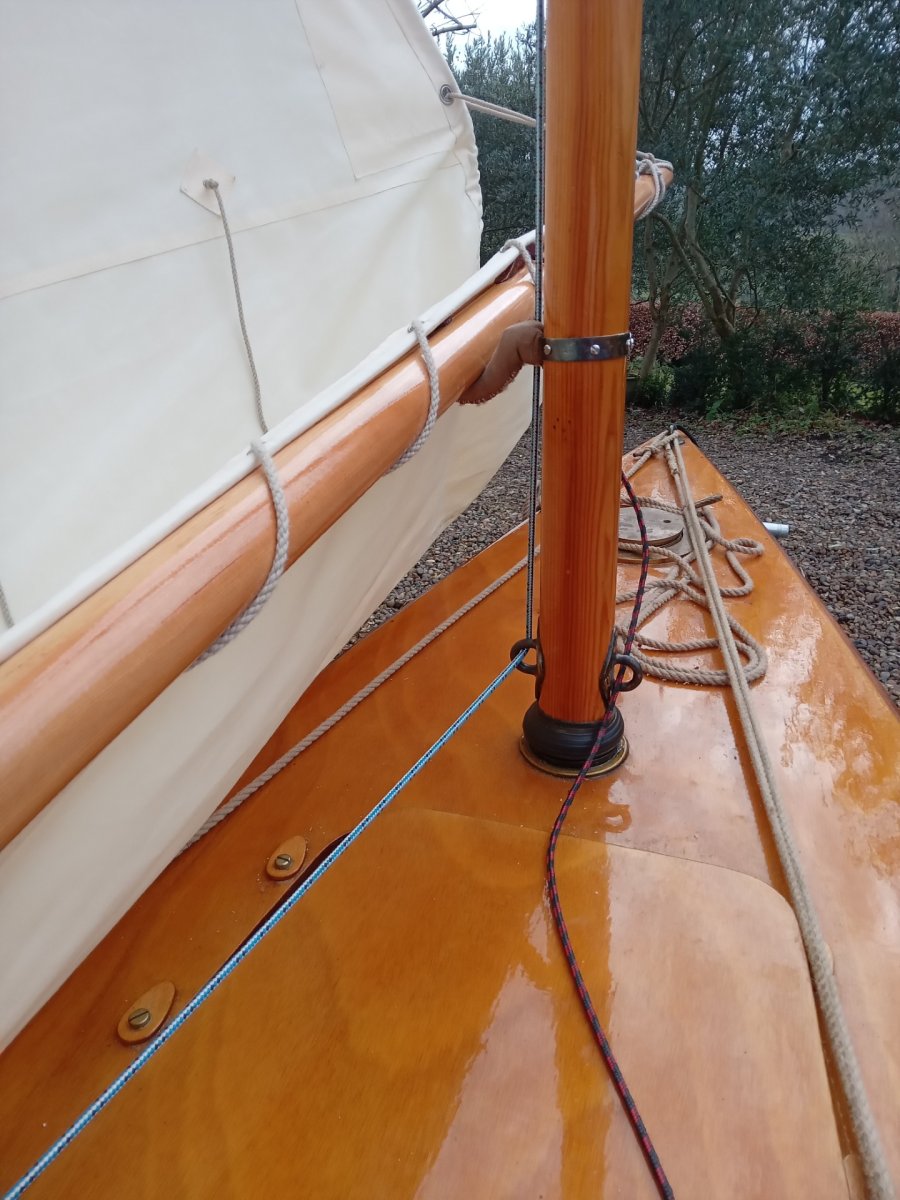

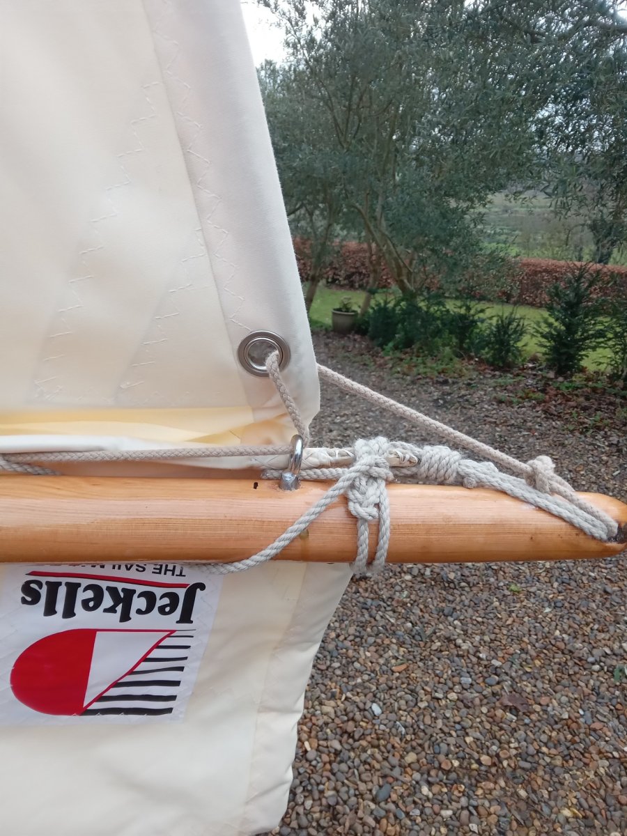

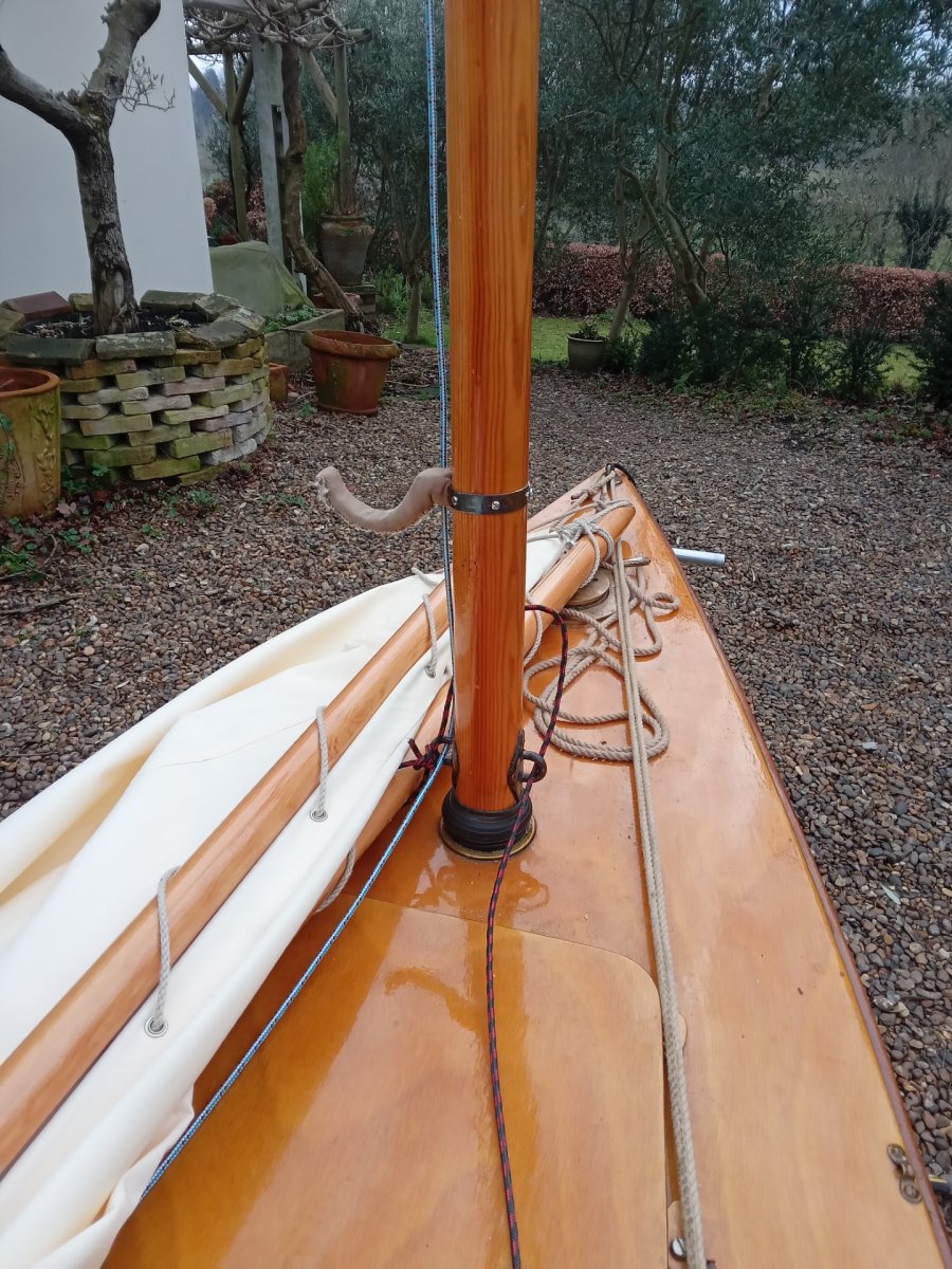

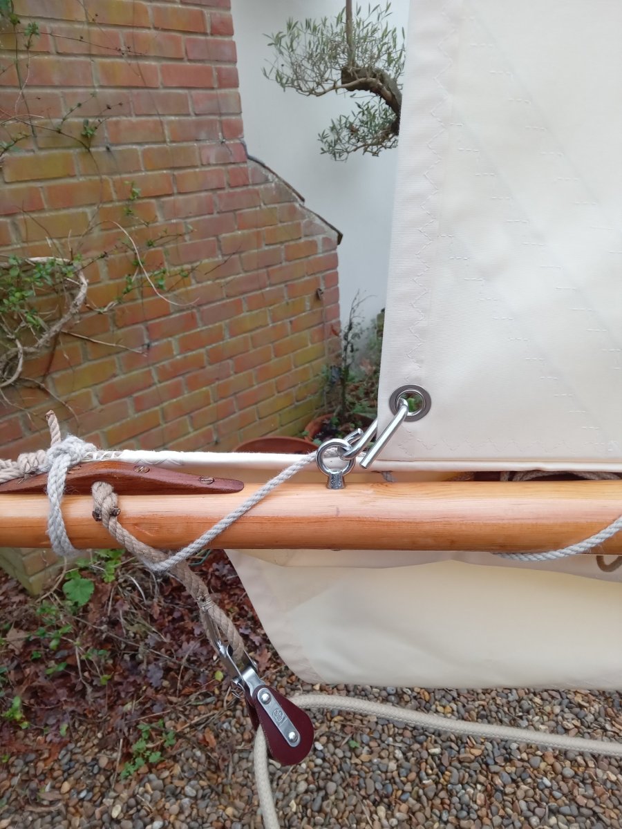

Well! The tack idea didn't work. It was too far away to reach, so I reverted to a reefing line here, leading back along the boom to a cleat over the sitting position.
The hook at the clew worked fine, and so did the boom support on the mast. Here are some pictures:-
Boom support:-
Boom support with boom on:-
Hook at clew:-
Reefing line at tack:-
