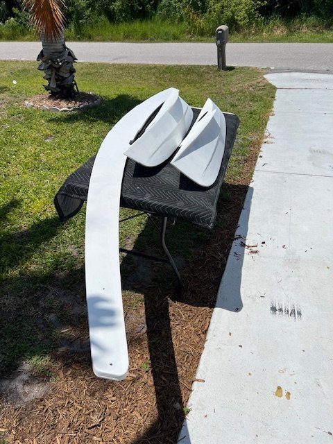

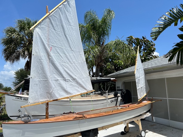

Almost there. Primer on the amas and the aka, should have final coat of paint in the next few days. Rigging is mostly set up but will need some adjustments. There is nothing in the plans for cleating off the mainsheet. I know... you never cleat off the main, but the reality is that you will need to sometimes. Does anyone have a setup for the main that they are really happy with?
