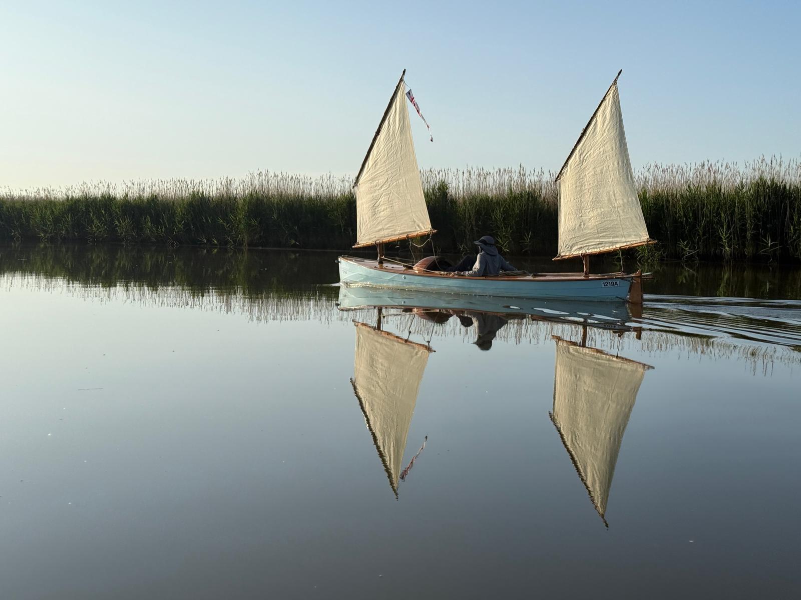

MartinC
Registered: 3 Apr 2020
Posts: 345
Re: Waterlust sailing canoe in Norway
One of my peddling trips!
