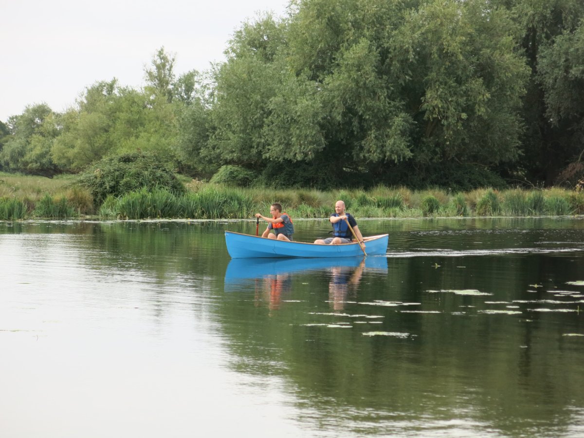

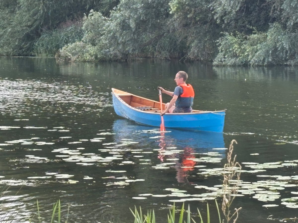

It's been a while but I wanted to do a final post about the canoe.
First off, the weight and handling.  Now I've gotten the hang of it I have no trouble moving and lifting the canoe by myself.  Getting the canoe from the ground onto your shoulders is something where there's a particular technique, so I recommend looking up videos.  I'm glad I decided to get the yoke rather than the standard thwart, it's very comfortable to carry.  Single-handedly getting the canoe on and off a roof-rack is definitely doable with practice.
The first time getting in the canoe I managed to capsize three times in a row.  This was quite surprising as it's never happened in any of the canoes I've hired.  My theory is that the problem was that it's quite a lightweight canoe, and I'm relatively heavy, having all the weight down one end shifts the canoe onto the bow/stern where the keel is quite sharp so very easy to capsize (a bit like a rowing shell).  Once we actually had two people in the boat the stability was a lot better, and no trouble getting in/out so long as one person steadies from the bank.  And it works solo when properly ballasted (sitting backwards on the bow seat with 15kg in the stern is just about enough for me).  It still feels less settled than the very flat-bottomed canoes I've been in before, but the flip side is that it's a lot faster and tracks better, and we've had no more capsizing incidents.  I guess I'll see if the different balance feeling is something we get used to over time - I'm finding it a lot of work to keep balanced but my partner seems to find it no problem at all.
I bought the "portage" kit from Thule to mount the canoe on my roof-bars and it's excellent, I'm really surprised how firmly held down the canoe is.  But the "feet" don't really seem that necessary, if you're on a budget you could do fine with some decent cam-staps plus improvised tie-downs for the bow and stern.
Currently the canoe is living on saw-horses in the garden covered by a porous sheet, so it's protected from UV, it does get wet but the water isn't trapped and it dries out well when it's not raining.  I'll probably try to store it in the garage when the garage isn't in-use for other projects.  So far the paint and varnish are holding up well: a few dings in the paint from putting it down on concrete sidings and bank-interactions while mooring, and a few scratches in the varnish from sandy shoes.  I'll try to do some touchups (and maybe more varnish coats in general) this winter.
And finally, some photos of it on the water!
