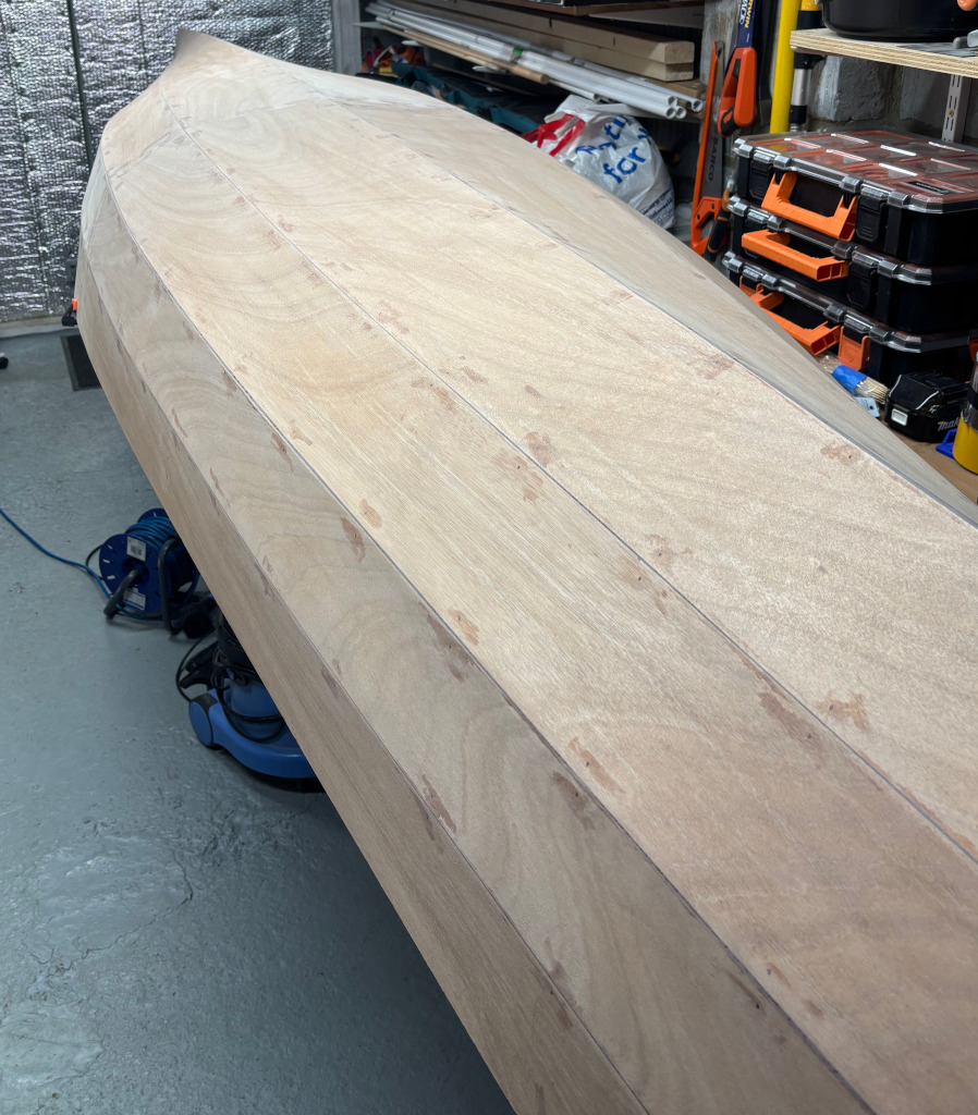

And here's where we're at now.  All the exterior joints are filled and all the holes are plugged from the outside (I took off the strap and did the central ones after this photo).  Now ready to get it flipped back over, sand the interior tabs, and start on the interior fillets.
I'm quite surprised that, so far, my limited space isn't being too much of a problem.  Even though I can only access one side at a time it's pretty easy to shuffle the saw-horses around to get to the other side, and once the epoxy tabs had cured it was easily strong enough for two people to carry out of the garage to turn around.

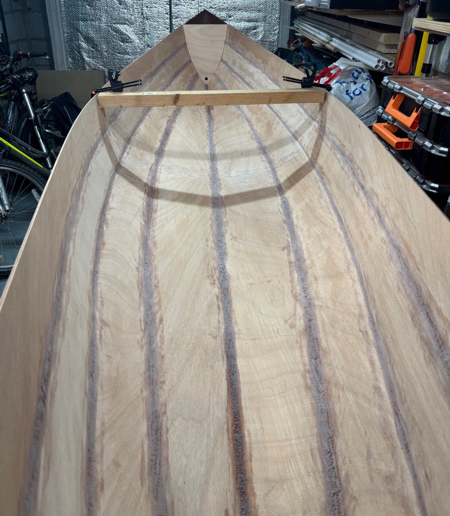

Once again I hadn't realised how long it's been since I last posted.  I'm still chugging along with the build, so there's quite a bit of progress to report.  I filleted the inside joints (this was a lot nicer and easier than I expected.  Highly recommend the filleting tools FBK sells, and I discovered you can tilt the tool to give an even larger radius), gave the inside and outside fillets a couple of weeks to fully cure, and then sanded the whole lot down smooth.  It was pretty easy to sand a nice radius on the keel and other outside joints which I think is probably important for the glass to lie nicely.

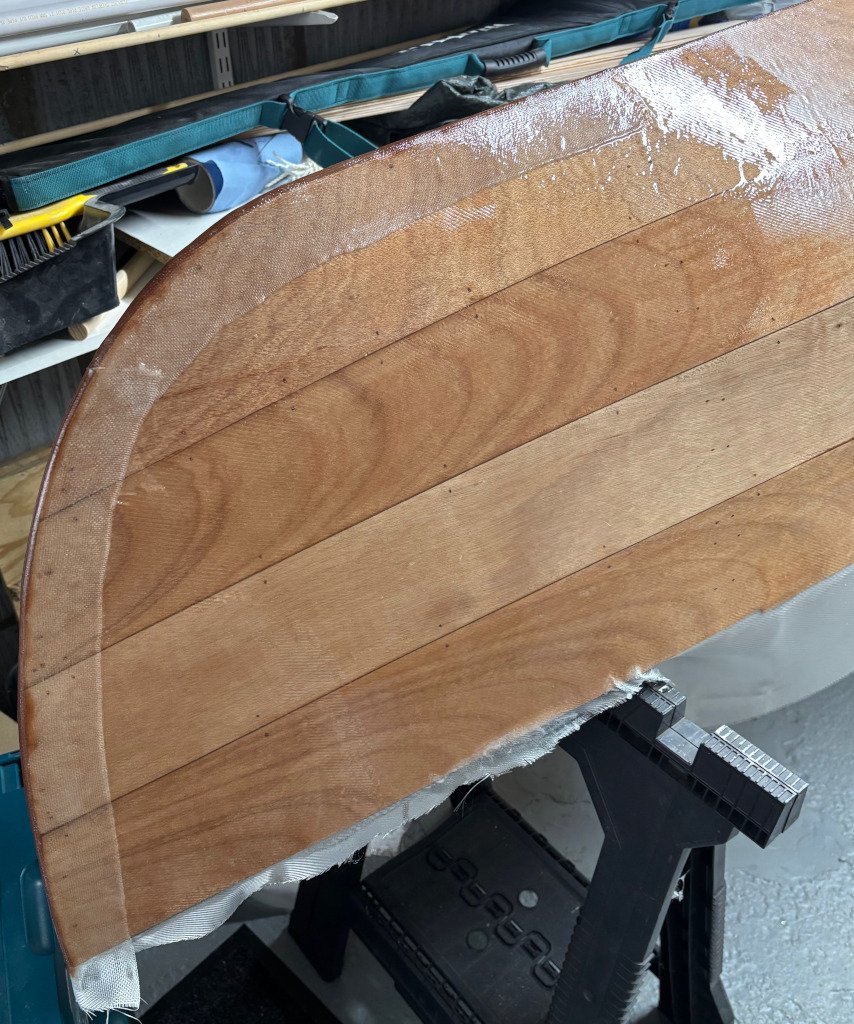

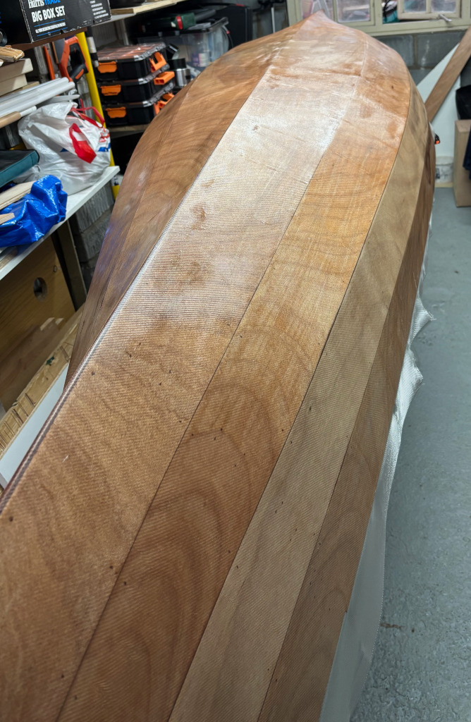

I discovered that the glass sheet provided for the inside was a bit too short to reach between the bulkheads so I proceeded to glass the outside of the canoe first (FBK have since posted me some extra glass to make up the gap - thanks!).  This wasn't too tricky but did take a *lot* longer than I expected, I wasn't taking my time but for me it was definitely an all-day job to get two coats of epoxy on the glass (with a few hours gap for it to tack up) and keel-tape.  I'm very glad I decided to do the fillets separately to the glassing, even though it meant some extra sanding.
The end result turned out okay but not perfect, so I think I'm going to paint the outside.  In particular the glass tape used on the keel hasn't really disappeared in the same way the glass sheets do.  I also should have been much more generous with the thickened epoxy under the glass tape, as I ended up with a few gaps in places.

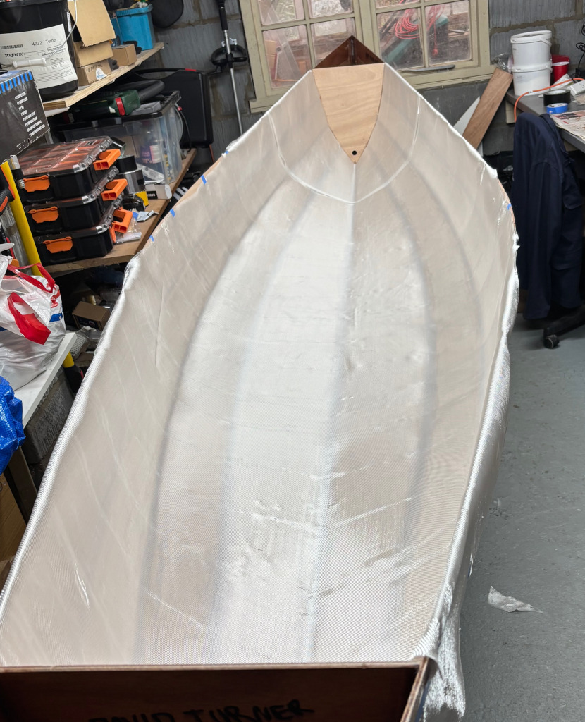

The latest job I've just finished is prepping the inside for glassing.  I decided to do this the day before actually epoxying so I can really take my time to get the glass sitting well and not have quite so much to do on epoxy-day.  One thing I didn't fully appreciate from the instructions is just how useful it is to stroke your glass!  Once the glass sheet is roughly in place you can spend quite a while firmly stroking the fabric and this makes a massive difference in helping it lie well on the surface.  This also really helps to remove any creases from how the glass was packed.  This doesn't work at all with grippy gloves on so I had to use bare hands.
