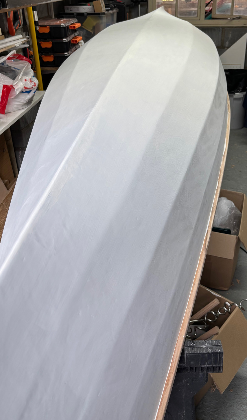

It looks like this build is going to be carrying on somewhat longer than I intended!  I thought the glass+epoxy application on the inside and outside had gone rather well and I was very happy with how the end result looked, but sadly the second coat of epoxy has failed to adhere properly over a lot of the inside and outside of the canoe.  I've been fastidious about mixing ratios and time, pre-warmed the epoxy, and don't have any sources of contamination like a fuel heater or air compressor, so my best guess is it's either due to condensation or amine blush.  Humidity reached 70-80% due to me breathing and the temperature falling and it seems like amine blush can be a problem even when re-coating on the same day.  From now on I'll be getting the garage properly warm and dry for any epoxy work and I'd advise extreme care if you choose to do epoxying in a cool humid space.
Scraping off the flakey coat of epoxy was very annoying but wasn't quite as awful as I initially expected.  First, I stuck and removed pieces of tape all over the hull to work out how bad the problem was in different areas.  For removal, the best method I found was using a sharp 12mm wood chisel bevel-up: the first coat of epoxy and glass were rock solid and very well stuck so the chisel doesn't tend to dig in too much.  In a lot of areas the epoxy basically fell off in sheets of 1-5cm.  In some areas I could remove the epoxy very slowly (a few mm at a time) but it seemed relatively well stuck so I've decided to leave it.  Overall it's taken me a few full days to do this by myself.
After scraping, I gave the whole hull a sand with 120-grit using my new random orbit sander (with vacuum dust extraction!).  Having scraped off most of the top coat of epoxy, what remains is a surface textured due to the weave of the glass.  It's impossible to fully sand into the valleys without also removing quite a lot of the glass so I went with a compromise where there are still some shiny spots in the valleys but most of the surface is scuffed.  Time will tell whether this was the right choice.  With fresh 120-grit sanding discs it's very easy to sand straight through to the bare wood so care is needed here.
Finally it was back to adding another coat of epoxy in a very warm, dry garage on a sunny day.  This seems to have stuck okay and the result is shiny.  There's no way I'm doing another round of scraping so I've crossed my fingers and haven't done any more tape adhesion tests.

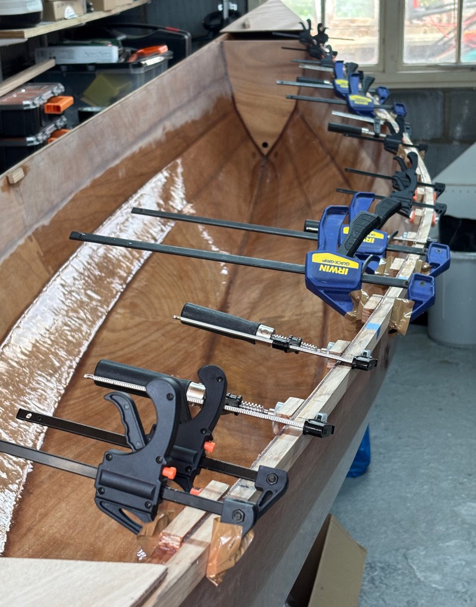

Shown here is gluing on one of the outer rails (before I finished scraping/sanding the inside).  Instead of screwing the rail from the inside in the bulkheads (as directed in the instructions) I decided to just use a large number of clamps and do one rail at a time.  This was fine to do solo but I do recommend a few dry runs as it is a little tricky.  Note the temporary thwart - instead of messing around with extra rope/clamps I decided to just drill two extra holes in the hull and screw this in place (with plywood pads on the outside to stop the screw-head mangling the surface), and I'll fill the holes later on.  Holes filled with the brown thickened epoxy just look like knots so I think this will look fine.

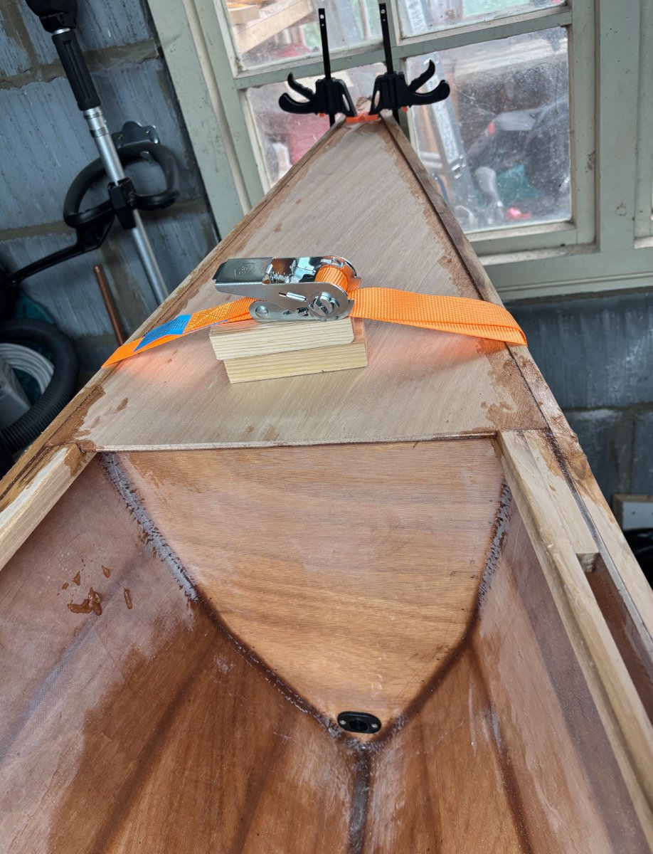

#12 14 Aug 2026 11:45 am
cillian64
Registered: 6 Nov 2025
Posts: 10
Re: Canadian Canoe build

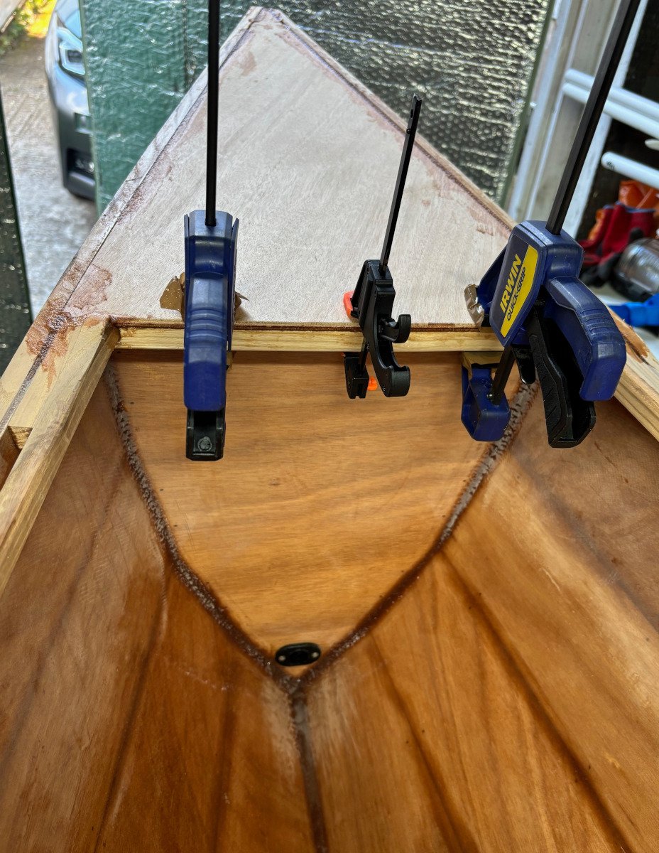

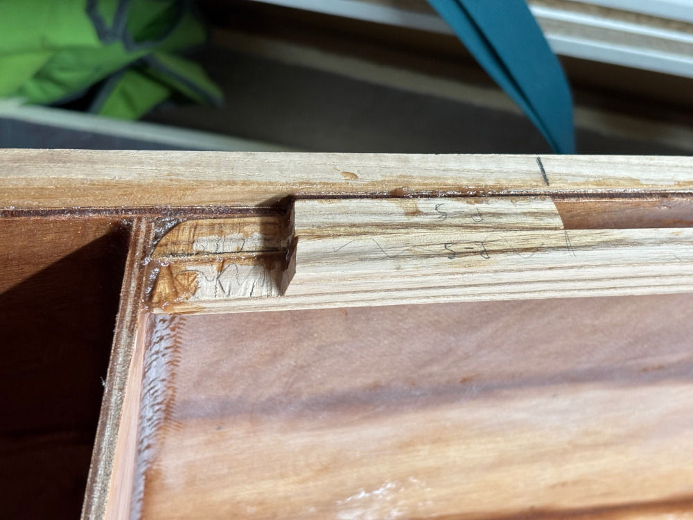

The aforementioned other projects are all done so I've been back on the canoe for the past few weeks.  It's actually finished now so here are some rapid-fire updates for the final part of the build.
I got the broken inwales cut up and glued on.  It turned out there was vastly more material than needed for the spacers (unless I've done something very wrong) so I've now got a stash of ash lengths for future projects.  This part really did need quite a few clamps, at least one per spacer if doing one side at a time.  Definitely clear off excess epoxy from the spacers before adding the inwales, as it's a pain to sand the gaps once everything is together.
The ends of the inwales also require some sculpting for the tank-tops which should be done before they are attached. But this doesn't need to be neat and it's easy to fill up any gaps by globbing in epoxy.
I then got the tank-tops attached.  One thing to note here: I was a bit worried that in places there was a gap between the edge of the tank-top and the gunwales. But it turns out that this gap, when filled with wood-flour-coloured epoxy, sanded, and varnished, forms a fantastic looking detail on the bow and stern.
And the final pieces to be attached, the tank-top stiffeners.  I did some elaborate carving so that these would hook under the inwales - I figured they will be used as handles to lift the boat so the extra strength might be a good idea.  And as usual copious quantities of thickened epoxy to fill in all the gaps left by my imprecise shaping.
The next step for me was rounding over all the edges on the inwales/outwales.  I could do some of them with a block plane and spokeshave but it also took quite a lot of sanding where I couldn't get the plane in.  I think it would be worth doing the roundovers before the rails are installed (maybe with a detail router), but remember to only round the correct edges, not all of them!

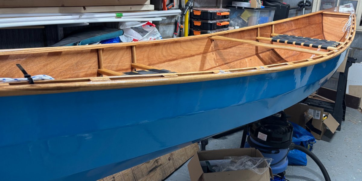

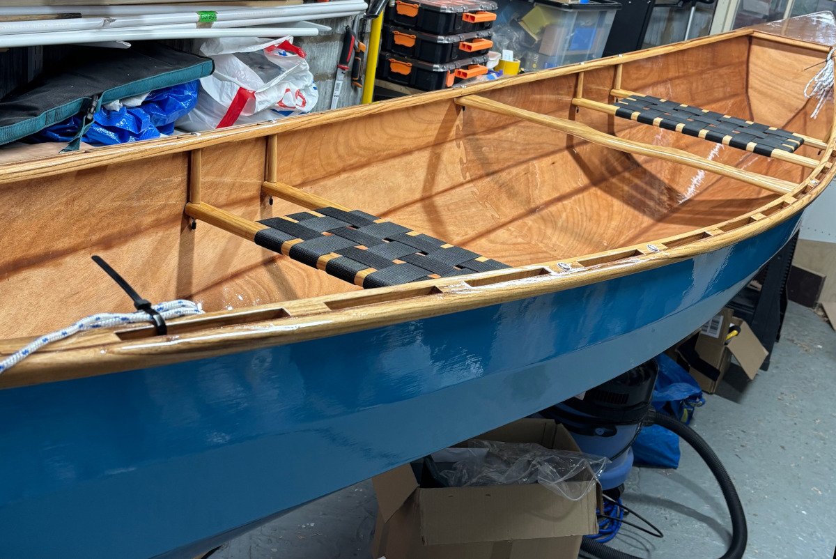

#13 14 Aug 2026 12:22 pm
cillian64
Posts: 10
Finally we're really onto the finishing touches!  I gave the inside and outside a sand with 180-grid on the random orbit sander.  This took some care as in places I really did want to flatten out the epoxy a bit, but it's extremely easy to go all the way through the epoxy and glass if you're not careful, especially the chines on the outside of the hull.

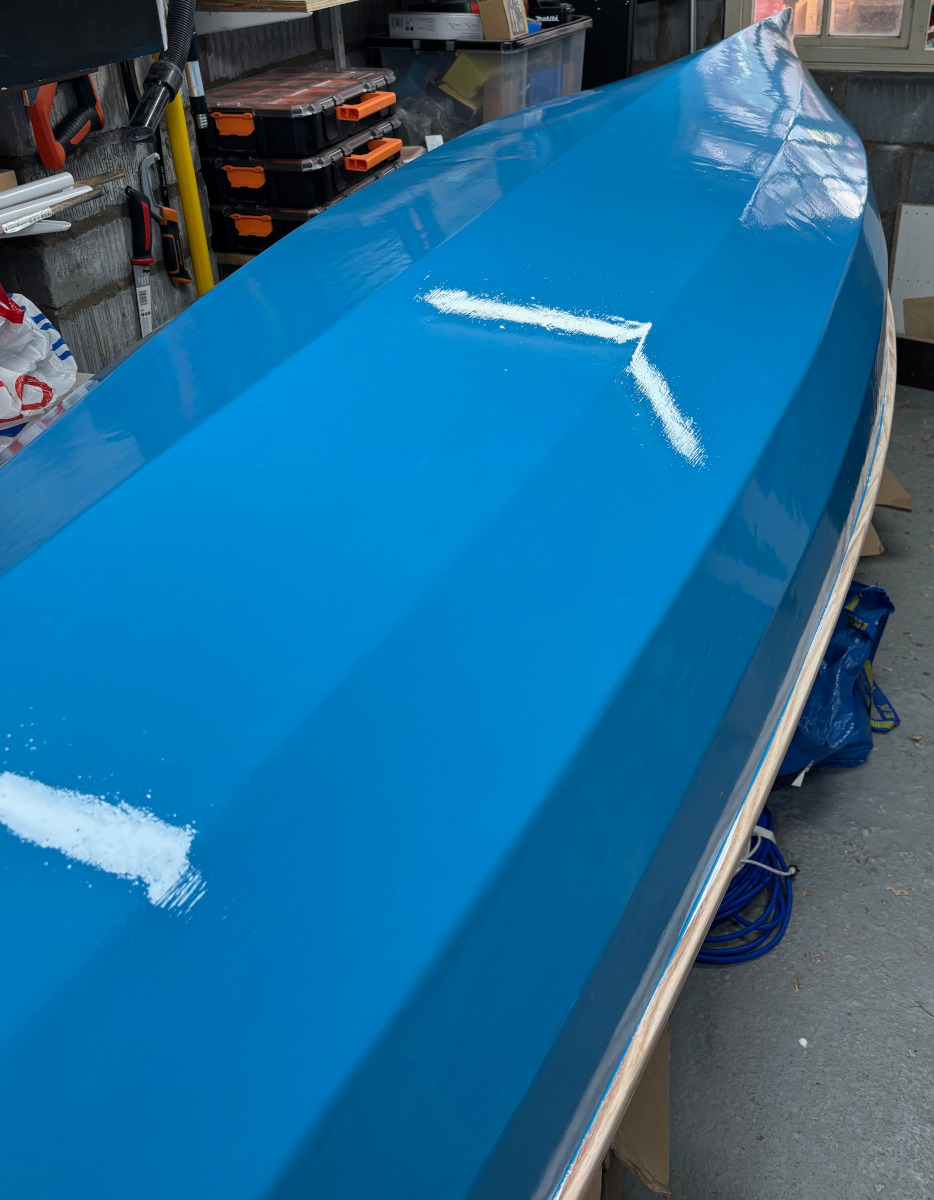

For paint on the outside I started off with 2 coats of teamac marine undercoat (1-pack), then finished with two coats of teamac marine gloss in arctic blue.  I bought 1L of undercoat and 2L of topcoat, but it turns out two coats of paint on the outside of the boat (applied by brush) only used about 600-700mL, so 1L of each would have been plenty.
Then for the inside, the ash rails, and the thwart/yoke, I went with coo-var marine varnish.  Where applied to bare wood this did need a light sand (400-grit) between coats to de-nib.  Again, 1L of varnish was plenty for two coats on the inside and all the woodwork.

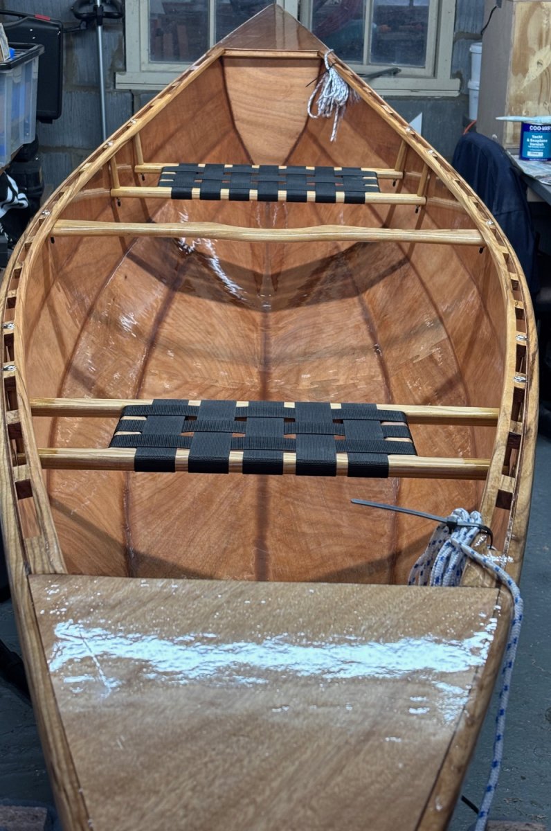

And finally, here is the finished product, complete with seats, spacers, yoke, and bow/stern painters.
I'm delighted with how it looks.  I had made the executive decision to not bother doing any fairing before painting - I just really wanted to get the canoe finished and on the water while there's still some summer left.  The gloss paint on the outside of the boat does show up bumps/dents more than varnish, but even on my boat (with some really significant scars from when I had to hack off the bad epoxy) this doesn't look too bad at all.  I was worried that the end result would look silly/amateur, but really it just looks like a slightly old/used boat which has had a fresh coat of paint, which I think is no bad thing at all.  There are some bubbles/pinholes/runs in the paint and varnish, but it doesn't bother me at all and isn't noticeable once you take a step back.
I also wondered if it was a good idea to paint the outside, given I'd be hiding the beautiful wood grain and also highlighting bumps/dents.  But I think it was absolutely the right choice, I love the contrast between the blue outside and wood inside and the arctic blue is a fantastic colour.
One final thing I wanted to talk about was weight, as it was something I had thought a lot about before starting the project.  I really wanted a canoe I'd be able to pick up and move around solo.  The FBK kit page quotes a weight of 18kg, excluding seats (I'm not sure if this includes paint/varnish).  I did an intermediate weigh-in post-epoxy but without rails, tank-tops, or any internals or finish and came in at 17.7kg.  I suspect I was running a bit heavy due to needing an extra coat of epoxy, and I was also rather generous with some of the fillets.  When all finished/painted/varnished but excluding seats/thwart/ropes, the weight was 21.3kg, and including seats/thwart the final weight is about 24kg.  You could probably shave a bit off this by having a thwart instead of a yoke, being more careful with paint/varnish application thickness, buying/making lighter seats (these Nova Craft ones are pretty chunky), and gluing in the seats instead of using hangers.  But I'm pretty happy with this weight for a wooden tandem canoe.  It's certainly very easy for two people to lift and move around.  I'll have to see about solo manoeuvring once I've got it out of the garage, but I suspect it should be manageable with some practice.
The paint and varnish have now had a bit over a week to cure, I've procured paddles and life jackets, so the maiden voyage is planned for this Sunday!
