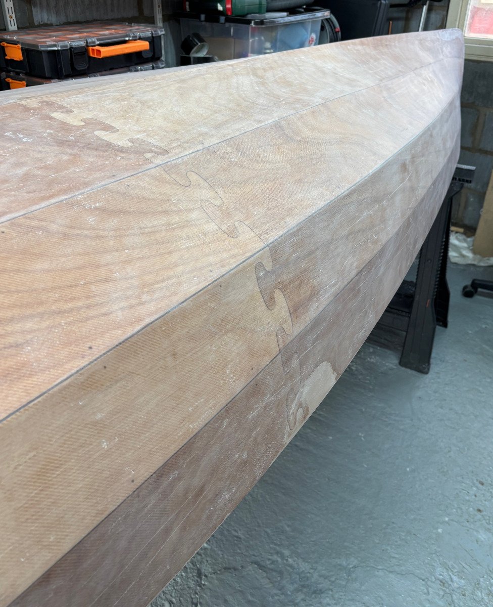

I spent a while cleaning up the puzzle joints and ended up giving a quick sand round all the ply pieces to knock off the splinters. There were also a few tabs left from the CNC cutting, I found a small block plane a very satisfying way to remove those.
Aligning the joints, I was surprised how much movement there was overall despite the joints themselves feeling pretty tight. Checking alignment against the plans is definitely not optional. This is one place where my improvised workbench-with-end-extensions made things quite a bit harder than they needed to be - I'd recommend setting up a solid workbench the full length of the pieces if at all possible. I think I got away with a string-line and some careful sighting.
The epoxy is messier and trickier than I expected. Previously I've only used standard 5-minute epoxy, this stuff is a lot runnier (at least before thickening).
I'm pretty happy with how the joints have turned out. Some sanding required, but there aren't any voids or big protruding globs. The heated box seems to have done its job as the epoxy was rock hard in less than 24 hours despite the garage being pretty cold

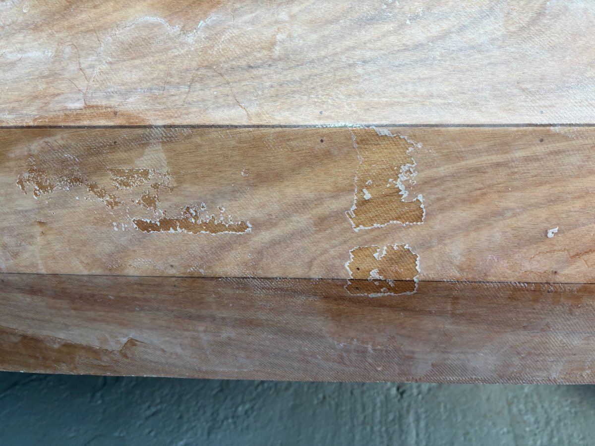

The latest job I've just finished is prepping the inside for glassing. I decided to do this the day before actually epoxying so I can really take my time to get the glass sitting well and not have quite so much to do on epoxy-day. One thing I didn't fully appreciate from the instructions is just how useful it is to stroke your glass! Once the glass sheet is roughly in place you can spend quite a while firmly stroking the fabric and this makes a massive difference in helping it lie well on the surface. This also really helps to remove any creases from how the glass was packed. This doesn't work at all with grippy gloves on so I had to use bare hands.
It looks like this build is going to be carrying on somewhat longer than I intended! I thought the glass+epoxy application on the inside and outside had gone rather well and I was very happy with how the end result looked, but sadly the second coat of epoxy has failed to adhere properly over a lot of the inside and outside of the canoe. I've been fastidious about mixing ratios and time, pre-warmed the epoxy, and don't have any sources of contamination like a fuel heater or air compressor, so my best guess is it's either due to condensation or amine blush. Humidity reached 70-80% due to me breathing and the temperature falling and it seems like amine blush can be a problem even when re-coating on the same day. From now on I'll be getting the garage properly warm and dry for any epoxy work and I'd advise extreme care if you choose to do epoxying in a cool humid space.
Scraping off the flakey coat of epoxy was very annoying but wasn't quite as awful as I initially expected. First, I stuck and removed pieces of tape all over the hull to work out how bad the problem was in different areas. For removal, the best method I found was using a sharp 12mm wood chisel bevel-up: the first coat of epoxy and glass were rock solid and very well stuck so the chisel doesn't tend to dig in too much. In a lot of areas the epoxy basically fell off in sheets of 1-5cm. In some areas I could remove the epoxy very slowly (a few mm at a time) but it seemed relatively well stuck so I've decided to leave it. Overall it's taken me a few full days to do this by myself.

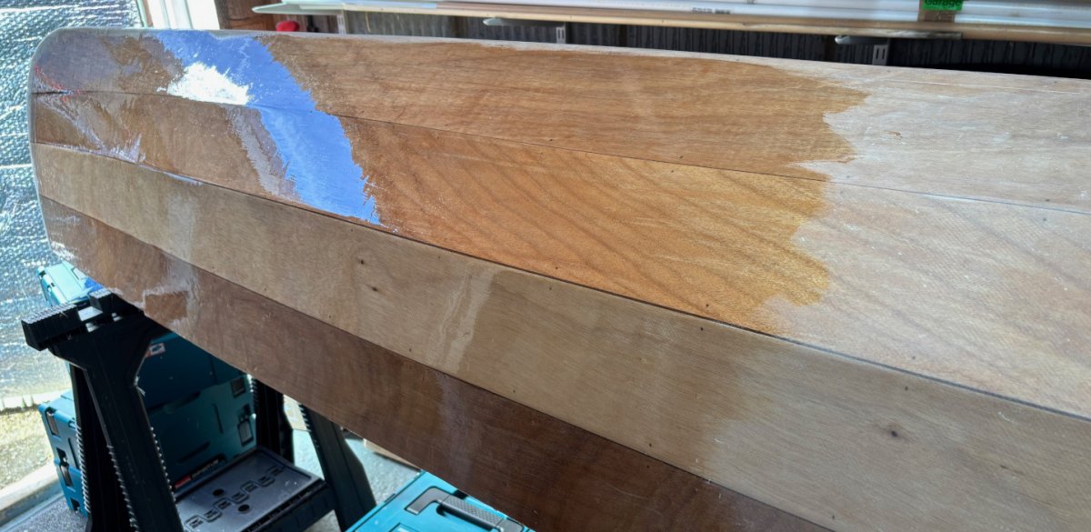

After scraping, I gave the whole hull a sand with 120-grit using my new random orbit sander (with vacuum dust extraction!). Having scraped off most of the top coat of epoxy, what remains is a surface textured due to the weave of the glass. It's impossible to fully sand into the valleys without also removing quite a lot of the glass so I went with a compromise where there are still some shiny spots in the valleys but most of the surface is scuffed. Time will tell whether this was the right choice. With fresh 120-grit sanding discs it's very easy to sand straight through to the bare wood so care is needed here.
Finally it was back to adding another coat of epoxy in a very warm, dry garage on a sunny day. This seems to have stuck okay and the result is shiny. There's no way I'm doing another round of scraping so I've crossed my fingers and haven't done any more tape adhesion tests.

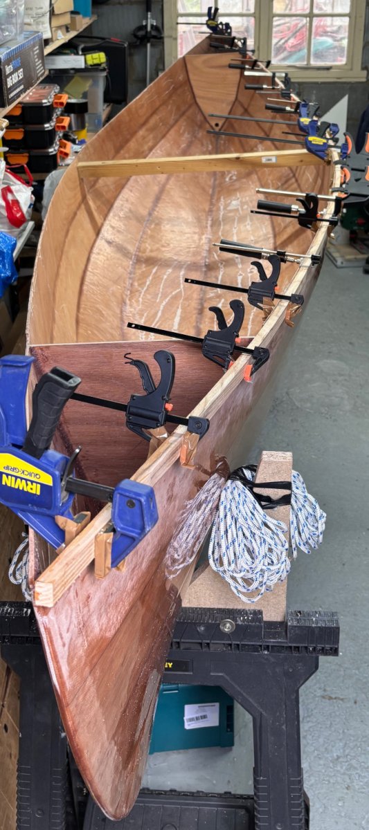

Shown here is gluing on one of the outer rails (before I finished scraping/sanding the inside). Instead of screwing the rail from the inside in the bulkheads (as directed in the instructions) I decided to just use a large number of clamps and do one rail at a time. This was fine to do solo but I do recommend a few dry runs as it is a little tricky. Note the temporary thwart - instead of messing around with extra rope/clamps I decided to just drill two extra holes in the hull and screw this in place (with plywood pads on the outside to stop the screw-head mangling the surface), and I'll fill the holes later on. Holes filled with the brown thickened epoxy just look like knots so I think this will look fine.
