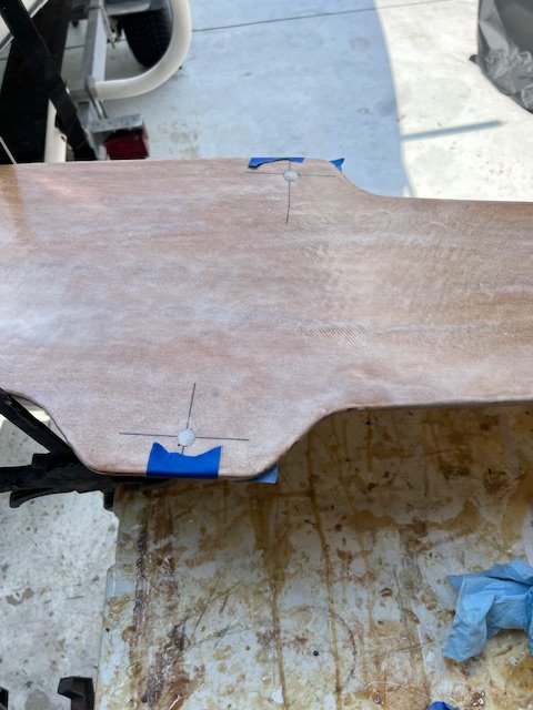

I am at the point where I am ready to mount the ama's to the aka. I can not find any detail in the instructions on where the mounting holes are located on either the ama or the aka. The instructions make reference to the inboard and outboard mounting holes when it is talking about centering the aka in the saddles, but nothing about where those holes are to be drilled. Anybody have any insight?

Yeah, I can maybe help with that.
I built my amas from CLC's printed plans package, still have the plans intact. I'll work out a schematic, based on the long axis from bow to stern, measure 'offsets' for those two hole centers, pass the numbers on to you later today.
You mount your aka yet? Got fastener holes located on the outboard ends of those yet?
When it came time to put everything together I found it helpful to measure the distance from the main hull's bow end out to each of the amas' bows, ensure those two dimensions were equal. If you can do that with one of the holes at the outer ends of your ama and your main hull's bow first, if adjustments are needed at the saddles, that's the time to do it. If not, then you can hang an ama off each outboard aka end then tweak the proper location of the second mounting hole so that those three bow ends are in a proper triangle, with the two sides being equal.
Post some pics of your recent progress, give us a look at how you're progressing!

I think I got if figured out.....drilled oversize, filled, almost ready to fill again...

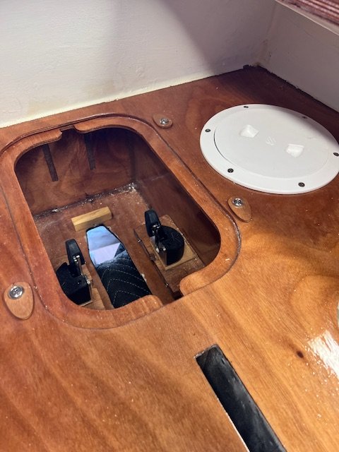

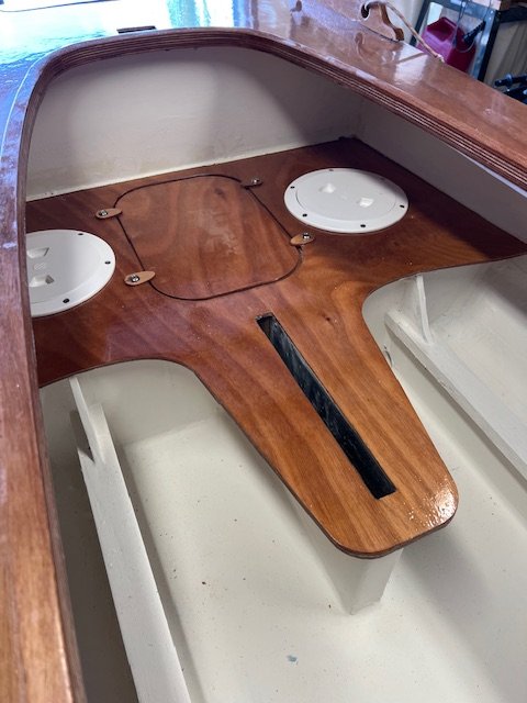

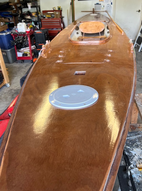

A few pics of the progress....Rudder and tiller done, hobie drive hardware all in

Re: Waterlust sailing canoe in Norway
BTW, Thanks spclark for the offer. I think I got it figured out....
